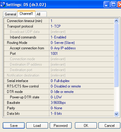

the \"Connecting..\" message means that the app is trying to connect to the UCM/Ethernet which is busy because it can only accept one connection at a time
If the status does not change to \"Connected\" do not try to log in as that will time out and cause delay. If you go to another application and return to the Comfort app you may see the message \"Disconnected\" That is normal and you can log in
If the status remains \"Connecting..\", perhaps a connection was lost without the app disconnecting
This can be avoided or reduced by setting Connection Timeout to 1 minute in DS Manager, see screenshot
This will disconnect if the connection is idle for 1 minute

- wexfordman - 10-03-2011
Thanks ident, made changes as suggested, will keep an eye on it !
