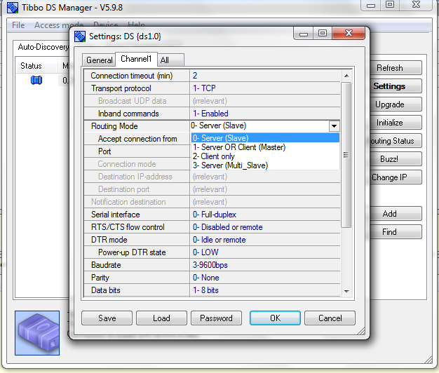

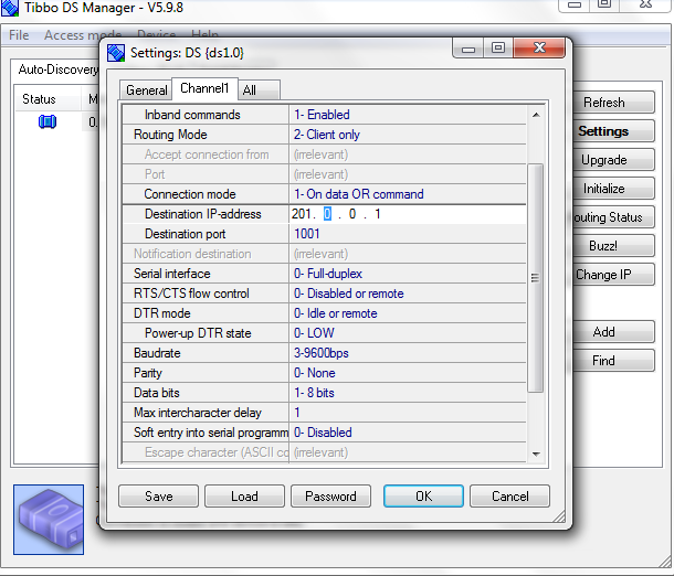

- ident - 05-18-2013
ETH01 and ETH02 are the submodules that are plugged onto the base UCM06
UCM/ETH02 looks like below
see http://www.comfortforums.com/forum113/2602.html on the forum
ETH01 has an orange module as shown below
To set the Routing Mode, open DS Manager in Options > Settings UCM Comunications after selecting Network
The routing mode is Server (slave) for normal operations where any client needs to communicate with the UCM by addressing the message to the UCM IP address/port
This is the mode used in normal UCM/ETH02 where the PC is the client and UCM/Eth02 is a server
Client Mode is where the UCM only talks with another device (server) by their IP  address/port.  In case of Client Mode, a Destination IP address and Port is specified. This is  often used when communicating with other devices
For example if the UCM/Universal were to communicate with another Comfort\'s UCM/ETH02, the Universal\'s DS Manager settings would be as Client and the other systems IP/address and port
