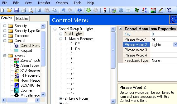

The Responses can be triggered by any Comfort Event, eg Zone On or Off, Alarms, Time programs, Home Control Menu, Sunrise/Sunset, Received IR code etc
The example below shows a Home Control Menu in Comfort which can control Dupline

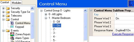

In the screenshow below, Master Bedroom On key activates the Response name DuplineB1On.
The free Comfort iPhone app will act on the programmed Home Control Menu
