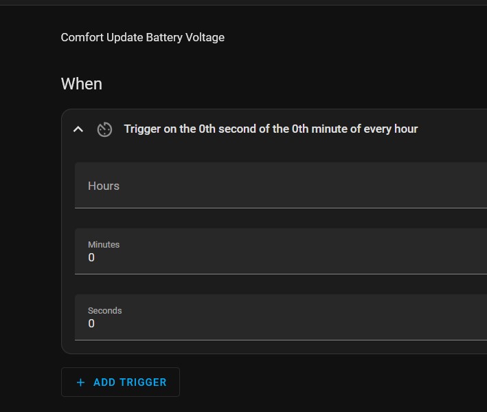

To enabled this, go to Settings > Automations and Scenes  >Automations.
Create Automation:
When:  Select Time Pattern > select an interval eg every hour as below;

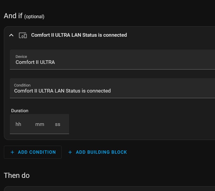

And If: selectDevice = Comfort ii Ultra,
Condition Comfort II Ultr Lan Status is Connected

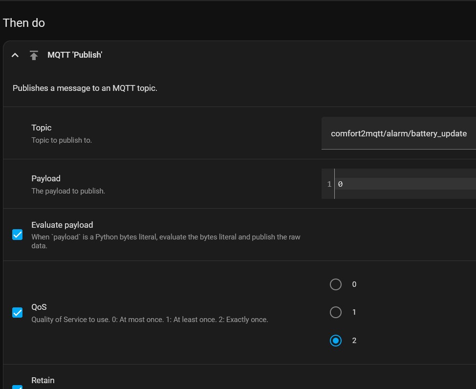

Then Do: Actions >perform an action
select  MQTT Publish  Topic comfort2mqttalarmbattery_update
Payload =0
Payload \"0\" means for Comfort and  all Connected Slaves.
Payload \"1\" means Comfort Only.
Press Save and name it eg Comfort battery Update Voltage

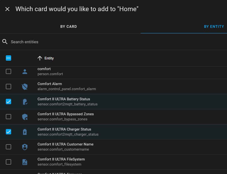

To see the Charger and Battery Voltage status on the dashboard, go to the Dash board, select the Pen icon  on top right to Edit, press add Card on bottom right.
Which Card would you like to Add ?
select By Entity
select the entities
select Comfort II Ultra Battery Status and Comfort II Charge Status, then Press Continue, and acceot the suggestion given by Home Assistant
