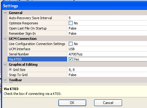

  4. The KT03 USB Port can be used to write and read from Comfort, just like a UCM. In Options > Settings, choose USB. There may be 2 USB ports detected if a UCM/USB is also available. You must know which one belongs to the UCM and which to KT03. A checkbox \"via KT03\" can be seen below the USB Serial number, which is to be checked if the USB port belongs to KT03. This allows Comfigutor to write and read using the KT03 USB port
