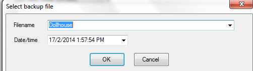

Each time you write to Comfort, the cclx file is automatically backed up.
You can restore by selecting from multiple backups in File > Restore from Backup

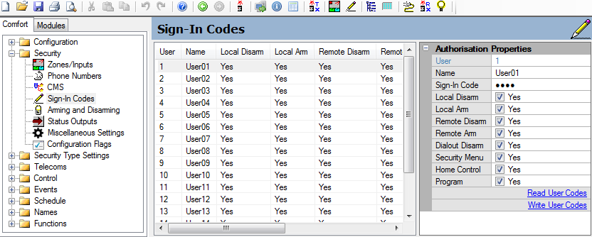

In Security > Sign in Codes, there are buttons to Write User Codes and Read User Codes, without needing to go to Write to Comfort or Read from Comfort
