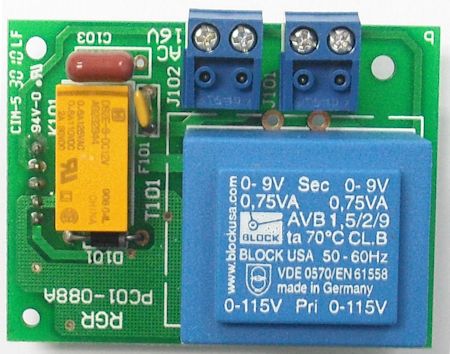

Some time ago we had a pretty close experience with an electrical storm (it took out a computer screen and the front end of a Video player/DVD recorder) and ever since then the ringer on my system does not ring the home phones.
I can hear the relay clicking away but that\'s all. I am guessing that the spike took out something on the RGR circuit board.
Is there fusible link I can look at/check or shall I just bin it and buy a new one?
Thanks

There are no fuses that can be changed on the RGR. A lightiing surge may affect other components which have not completely failed so it is adviable to buy a replacement
Is it the RGR05?
First remove the RGR from Comfort and make sure everything is working well without it (in case there is damage on Comfort as well)

You can add an attachment in the reply, there is a link to browse for file at the bottom of the reply
The picture is RGR03
The main module that you see on top of the RGR is probably the part which is damaged Unfotunately that component is no longer manufactured
But I will check if RGR04 or RGR05 can replace that

I notice that CBus shop still have the RGR04 in stock. What is the difference between the RGR04 and the RGR05?

\"RGR04 uses a different IC module to do the ringing\"
Thank you for the detailed reply.
Am I to assume you released the 05 simply because components for the 04 ceased to be available?

That is correct
It often happens
