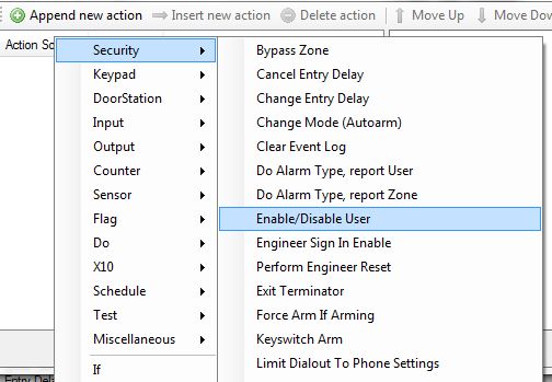

#6
Quote:I too would like to be able to give our housekeeper a code and it only work on certain days / times - perhaps something to consider for a future update?
User code which is enabled or disabled based on time programs is a feature under development.
This is different from a user being able to disarm only certain areas leaving other areas armed which is a different requirement

#7
Thought also needs to be given how this timed user code will work in practice :
1) Cleaner arrives 5 mins early - enters property causing entry delay to execute - unable to enter code disarm code due to it being outside of allotted time - alarm goes off
2) Cleaner overruns allotted time and is unable to arm system
Some logic and audible announcements could be built around this but its not as straight forward as it first looks.
